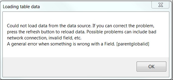

I've created a survey using an XLSForm with a repeat block.  There's no problem in publishing, downloading, or executing the survey or uploading data, and the related records and attachments show up when I open the hosted feature layer in the ArcGIS Online map viewer.  I then tried to open up the hosted feature layer table in ArcMap and access the related records table via ArcMap, and I can get at the feature layer records.  However, when I try to access the related table, I consistently get this "Loading table data" error message:

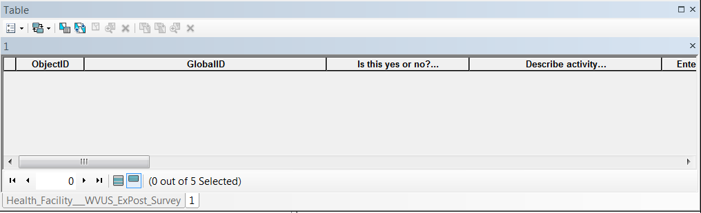

 I get no records on the output table - although the status line shows that I have 5 records available, which is the number of related records I added to my example survey feature record when I did the survey:
