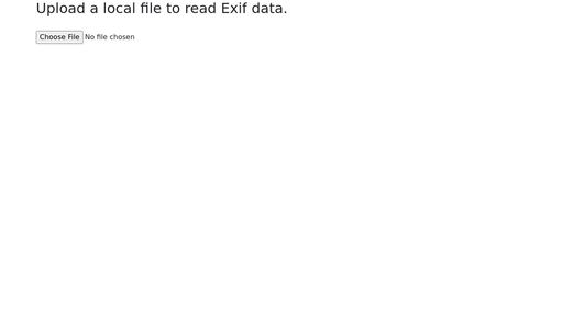

It might be removed by the phone when you upload it:
https://forums.developer.apple.com/forums/thread/678109#:~:text=If%20you%20UPLOAD%20a%20photo,the%20....
can test here if was already removed: https://codepen.io/zahamm/pen/oNEGbbY
