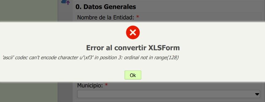

I´m trying to use the external choices with Survey 1.2.12, when the app is converting to XLS Form, the application shows this error:

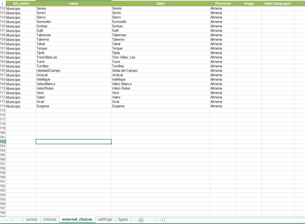

I don´t know why this error happens, I´ve created the external_choices:

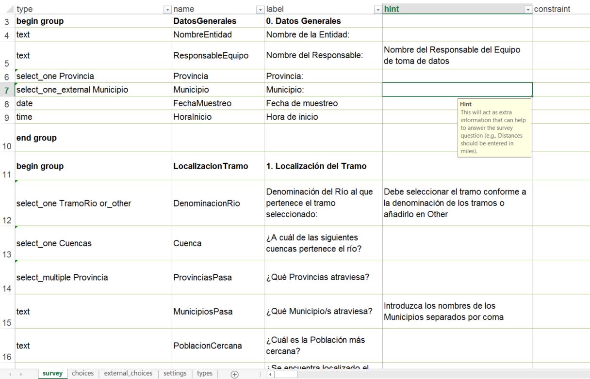

I ´ve created the select_one_external in survey and the relation with Provincia in the choice_filter
${Provincia}=Provincia

Juan,
We reviewed your XLSFile and discovered the source of the error. It looks like the validation is failing due to the nonASCII characters in the label column of external_choices sheet. The Survey123 team will review this issue and provide a solution soon.

Juan_JoséPino_Povedano
Ok, I´ll try to no use that kind of characters.
