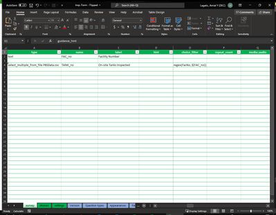

I'm trying to set up a form in Survey123 Connect to have two questions:
  • the first question asks for a facility number
  • the second question is supposed to have an external choice list. The responses displayed should consist of the names of the tanks within the facility identified in the first question. (Choice filter for this question is tied to a CSV called PBSData.)
When the second question type is set as "select_one_from_file PBSData.csv", the responses shown have radio buttons and the user is able to select just one of the tank names. However, if it's set as "select_multiple_from_file PBSData.csv", the radio buttons do become checkboxes but clicking on one checkbox causes all of the checkboxes to be ticked.
Has anyone run into this issue previously? It seems like I'm missing something basic.

The CSV has no 'name' column. It won't work without a name column.
Not sure why there is a regex function in the choice filter column. It would return 'true' if the input was correct but I don't think it applies an actual filter?
I would recommend reading the blog post above. To achieve what you are after you would:
  1. Create a CSV with two columns - 'name' and 'label' - these are your tank options. Name is the value, label is what the user sees. Don't use special characters in the name column.
  2. Add a third column e.g. 'facility' that can act as your choice filter. e.g. tanks ABC, ABD, ABE can be allocated to X facility if the 'X' value matches the facility column.
  3. Add a choice filter to your select_multiple question: facility=${Fac_No}

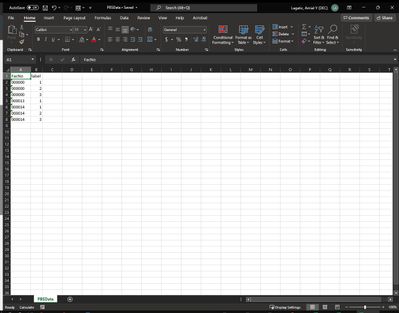

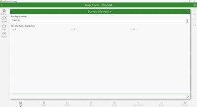

aytlDEC
Apparently I can't upload CSVs but here are screenshots of the CSV, the xls form, and the form itself. I'm fairly positive it's formatted correctly since it's a really basic form.
