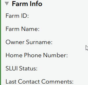

Hi there
I am working with a user with this workflow
They are using an Explorer Map > they select a polygon > Popup with a link to a Survey123 which opens successfully
Currently they use a CSV file (which has the attributes from the Explorer map)using the Pull Data function that populates some of the survey as notes. >
However is it possible to use the attributes from a featureservice to populate as notes for the header of the survey ?

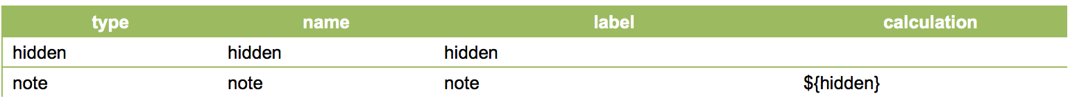

JohnathanHasthorpe
Hi John
I'm assuming the following:
- You are using custom urls to populate a question, which then triggers the pulldata to populate a number of other questions.
- You want to use custom urls to update a note question in your survey.
While it is not possible to use custom urls to write to note fields, it is possible write to hidden fields. So you can use a hidden field to update the contents of your note field (using calculate):
I hope this is what you meant. If not please let me know.
Thanks
John

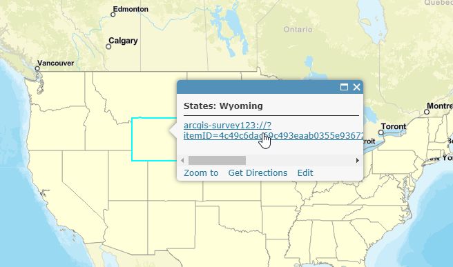

JohnPlunkett
Hi Jonathan
Thanks for your response, this was not quite what I am after but I have resovled it -
I found this blog post referenced here
https://community.esri.com/groups/survey123/blog/2016/07/30/understanding-survey123s-custom-url-sche...
So with my webmap
http://spt-eaglegis.maps.arcgis.com/home/webmap/viewer.html?webmap=e8db8c3ac74e445c8d4ffb4335f769f1
Click on any of the US States Polygons - and it opens up my test survey with some attributes populated. -
Will notes be supported by a custom URL Scheme in the future?
