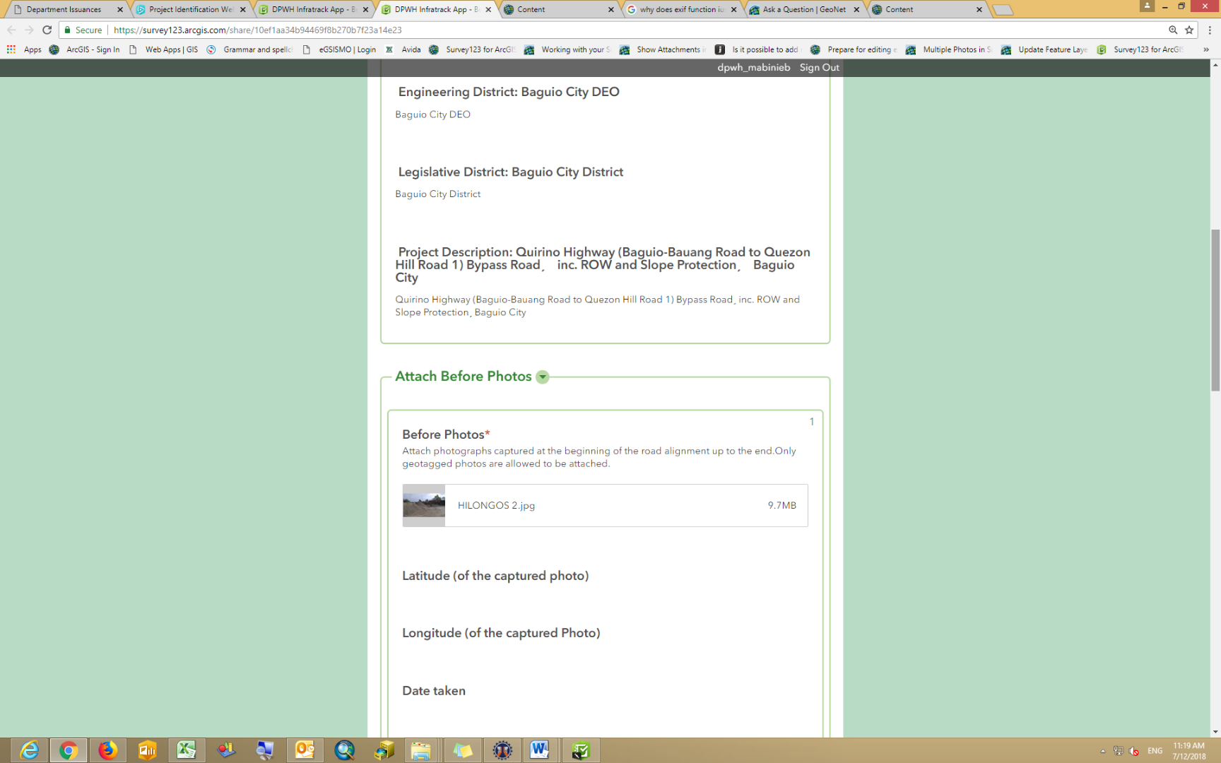

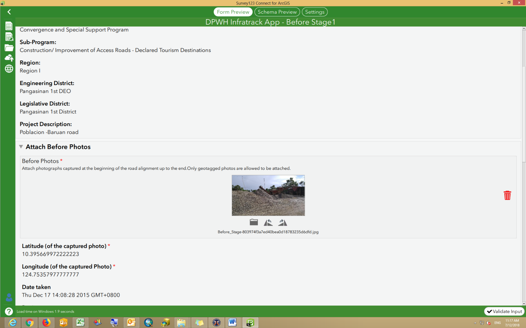

Thanks for answering my question. Yes the 'pulldata("@exif", ${image}, "gpslatitude")' works fine. The image is in a repeat so once I click the "plus" icon to add an attachment the coordinates metadata are being pulled from the first attachment. However the 'pulldata("@exif",${image},"ImageDateTime")'   is not working. See screenshots below.
Picture 1: Before clicking the "Plus Icon"
Picture 2: After clicking the "Plus Icon"

JohnathanHasthorpe
Hi Emilyn - I have replicated the issue and have raised it with our development team.
I'll update this post when I know more.
Thanks
John
JodyZhengLiu
Hi Emilyn,
This has been fixed in the web app and will be available for our next release (version 3.4) late May. Would you please have a try then?
Thanks and best regards,
Jody Zheng Liu
EmilynMabini
Thanks a lot!
