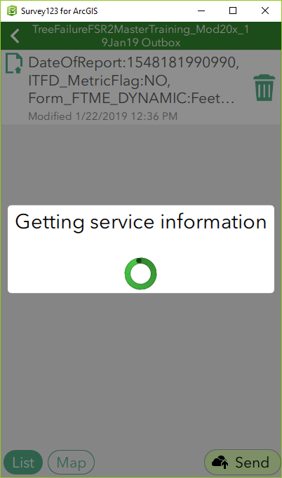

I have a form recently republished and in AGOL when I try to open it in the browser I get the (see attached) load form error error.  This is new. also getting a "hangup" if I open the same form in the desktop App in this image. never gets past this point - Probably related to browser error?!
Just republished this form with some changes in choices, but had no publication errors or issues.
Form created in current Survey123 Connect (3.1.126).
I open in Survey123 Connect and republished it to no change.

The hanging you see indicates a problem with submission.  Can you create a log file (see Troubleshoot—Survey123 for ArcGIS | ArcGIS ), attempt submission and then provide the log file to diagnose the issue?  Feel free to e-mail me at jtedrick At Esri.com

Final resolution to the “webform” and re-publishing “hang-up” problems I was experiencing…
J. Tedrick (Esri) had requested a log (click here for those instructions) of the Survey123 Connect re-publication which I provided via e-mail.
He reviewed that log and determined that the “hang-up” occurred because my desktop form was pointing to an invalid ArcGIS Online (AGOL) folder.  He asked (suspected) if I had possibly renamed or moved a folder and that the mismatch was created.  I had actually deleted the folder at AGOL in attempt to resolve the webform error!
He suggested that I correct the problem by:
  • Getting the AGOL folder data-id for the folder
  1. Right-click on folder in AGOL contents ==> folder
  2. Select Inspect Elements
  3. Copy data-id and replace the desktop folder pointer, ownerFolder in the “.iteminfo” file (open with a text editor)
  • Because I had deleted the folder at AGOL this was not possible
  • But, for future reference, these MUST match!
My resolution was:
  • In Survey123 Connect I created a “clone” of my otherwise “good” form by…
  1. “New Survey”
  2. And then “File”
  3. I opened the otherwise working form from the old folder
  4. This created a new set of files for the “cloned” form
  5. I then published this which updated the “.iteminfo’ file to match the newly created AGOL folder.
  6. Everything works now, and I can modify and re-publish the form without any “hang-ups” (i.e. failure to complete the publication to AGOL)
