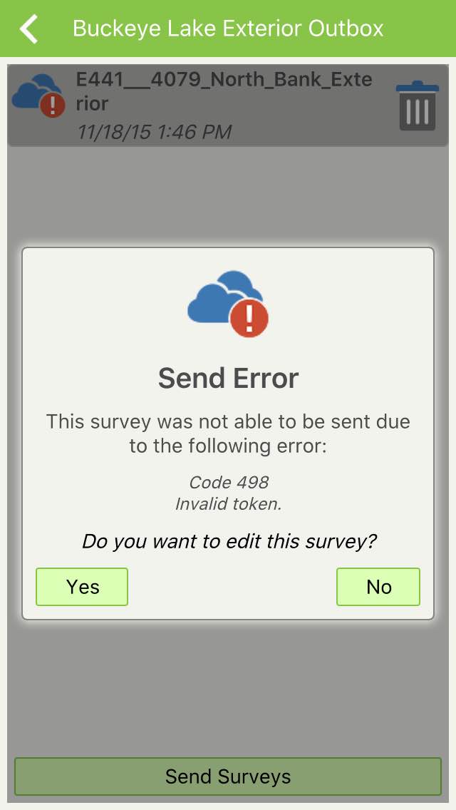

I have a number of surveys on my mobile device.  When I attempt to upload from the outbox i receive the attached error.  Any suggestions?

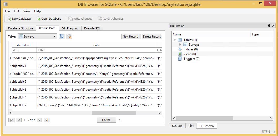

I am glad that we were able to determine the source of the issue. You can recover the data from the mobile device but appending it to the existing feature service will be a manual workflow.
1. The survey is stored in a SQLite database on the mobile device
2. Go to the folder location on the device to get to the file. For example: Computer\Note 5\Phone\ArcGIS\My Surveys\Databases
3. Download a DB Browser for SQLite
4. Open the .sqlite file using this application.
5. The inputs are stored as you can see below:
6. You can manually create a point feature on the existing survey feature service in ArcGIS Online map viewer, and then fill out the corresponding attributes by cross referencing your SQLite table.
I hope this helps.

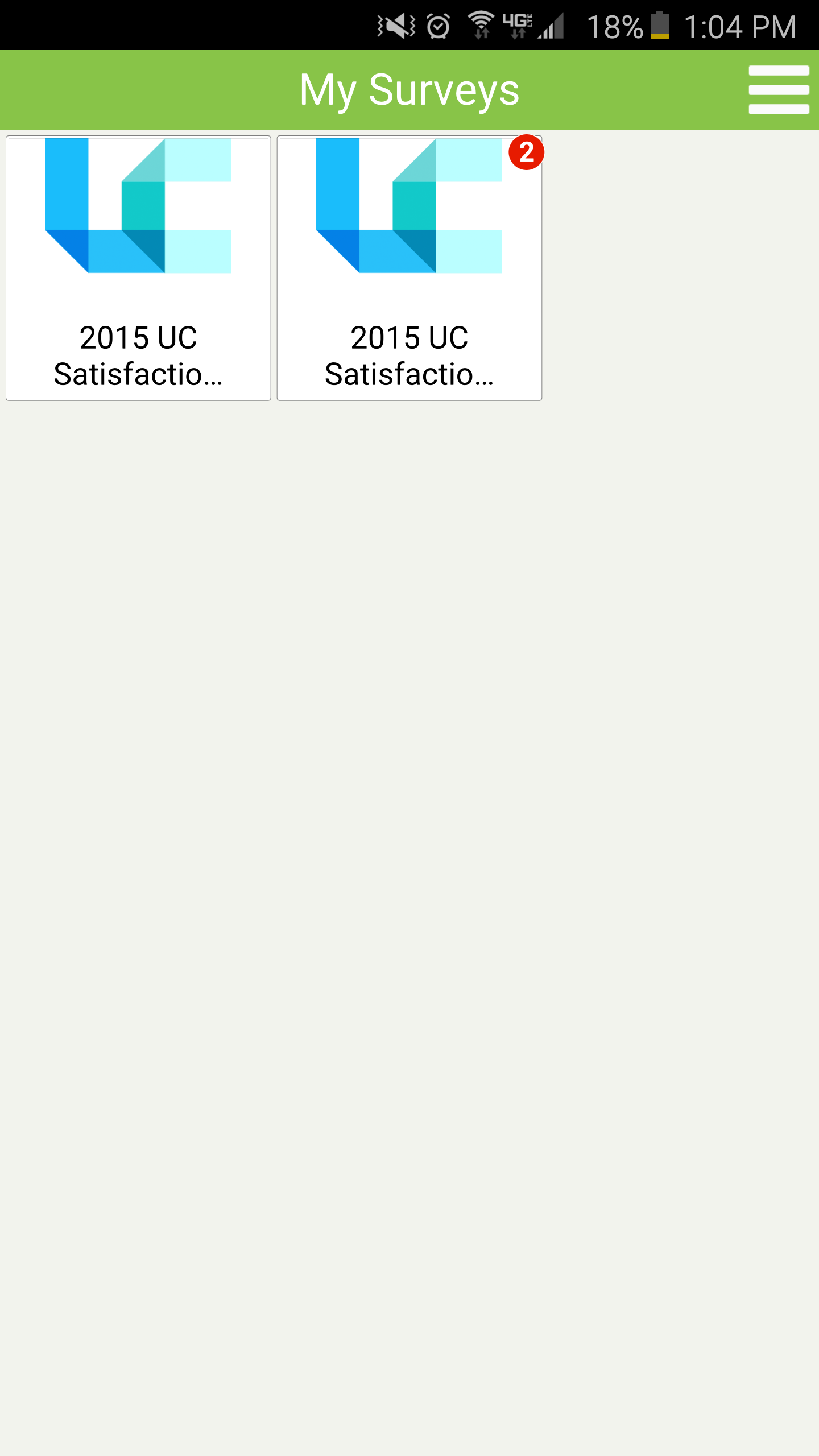

It is possible that this specific user might have an older version of the survey with the same name on the device. Does the issue happen for this user for multiple downloaded surveys? Did you by any chance deleted and republished, or modified the survey after this user already downloaded it to the device and collected data? For a quick test, have that user download that specific survey once again and see if they can send the survey data.

in the meanwhile, another team member just received the attached error on the same survey and he has been successfully syncing these surveys.

Do you know what version of the Survey123 app these users are on? The latest version is 1.1.18.
If the user is able to download the same survey again (without deleting the one on the device), this might indicate that there were some changes on the survey or the associated feature service. In this case, the user will have two surveys on the device with the same name. However, you can tell the difference between those surveys as you can see below:

Thank you for the reply.  I am  unsure of versioning.  I believe it was installed on the devices early this week (likely 1.1.16).  it appears as though an update has been 'pushed' to my device (i'm not sure about the field crews) last night November 17 and my own device is now running 1.1.18.  Could that be a problem?
I'll tell them to try and redownload the surveys...Any other suggestions?  what about the token error?
I hope this helps.
Fasil T.
