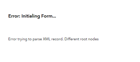

I am currently receiving the error above when opening the survey in Internet Explorer. Via Internet Explorer I have tried changing the document mode to the following and the survey does not work:
  • 7 Mode
  • 8 Mode
  • 9 Mode
  • 10 Mode
  • Edge Mode
This issue only seems to occur when parameters are added to the link.
This issue is not occurring in Firefox or Google Chrome.
This is a new survey that has been created after Survey123 v.2.6.4
I have attached the survey configuration as well.
Can someone help?

Hi Francisco,
After looking at your XLSForm, it appears that you have placed a calculation in the relevant column of the fields that are not showing, or passing parameters, which is not applicable.
For all these fields, you have a calculation stating ${Contractors} = 'Maybe', however there is no choice value of 'Maybe' that applies to your field named 'Contractors'.
This may have something to do with the error.  Can you please review your XLSForm and attempt to address this, then try again?

Unfortunately, there is no way for the form to know where to store the value prior to satisfying the relevancy which you have assigned to it.
In order for the parameter to pass, you must add a value of 'Maybe' to your choices sheet.
Another option that may work for you, would be to use the 'hidden' field type for those questions, and set them to the appropriate bind::esri:fieldType.  This way, the questions would never appear to the submitter, but you could pass parameters and/or edit the values after submission.

Hi fandrade86,
As per our work on the support case, I have logged a defect for this behavior.
BUG-000111386: Internet Explorer generates "Error trying to parse XML record. Different root nodes" when opening a custom Survey123 URL to auto-populate fields.

I apologize for the inconvenience that your company will be facing due to this defect. Yes, it did work previously and our dev team has set the current status of this defect as "In Product Plan".
You can keep track of the defect on our support website: BUG-000111386: Internet Explorer generates "Error trying to parse X..
