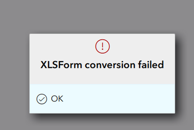

I have a survey with a lengthy choice list.  I added about 20 new options to this list and now my survey will not load in Survey123 Connect and gives the message:  "Error Converting XLSForm" without any further details.  When I copy the XLSForm and create a new survey from the copy the form loads just fine.  Any recommendations on how to fix this?
Thank you,
Dan

I am having the same issue. I have a hosted feature layer that I created with a file geodatabase and when I use the layer to create a new 123 form I get the error Error Converting XLSFOrm and the following.
Going to try some other things out.
Thanks,
LTK
TimothyKing3
Regular Contributor
I was able to figure it out.  One of the staff names had a character above the e for accent and when i changed it in the field name it worked fine!
