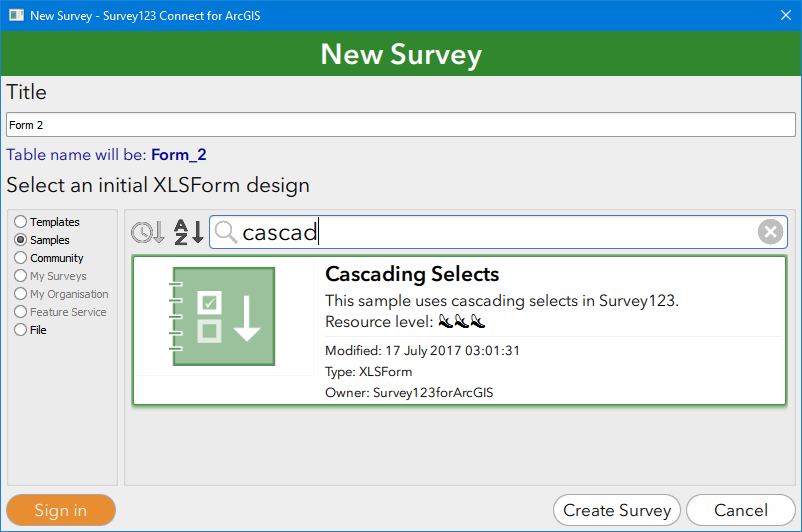

MichaelKelly
Hi Brandon - what I think you're looking for is Cascading Selects. There is a sample form accessible through Survey123 Connect as below:

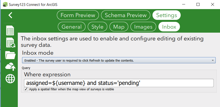

When attempting to refresh my inbox I am getting error Code 400, Searching for surveys: Cannot perform query. Invalid query parameters.
I followed this example from the survey123 blog shown below, replacing only the words status (with my survey field name) and pending (with my desired result). I have a type username field in the survey as well (field is username). I tried removing my additional parameter and just going with assigned=${username} as my only parameter, but the same error msg appears when I publish and refresh my inbox. Any help on this would be appreciated.
JamesTedrick
Esri Esteemed Contributor
Hi Adam,
I just attempted to replicate this with an Inbox survey I have and it worked correctly (in my case, the sql statement was
Editor = ${username} and county = 'Montgomery' for http://services5.arcgis.com/jMCHJcLe13FaKCFB/arcgis/rest/services/Water_Stations_Test/FeatureServer/...  ).
The most common issue for this type of error is that a field name is wrong - you may want to double-check the name (and possibly the capitalization) of the field name (not alias).
In terms of debugging, it's helpful to try out the query first at the 'Service URL' query page to make sure the query is valid. For my example, you would go to http://services5.arcgis.com/jMCHJcLe13FaKCFB/arcgis/rest/services/Water_Stations_Test/FeatureServer/... and in the 'Where' box place the sample query, substituting a real value for ${username}.  In my example, that would be Editor = 'jtedrick_Survey123' and county = 'Montgomery' .  It's also helpful to have a value of * in the Out Fields box to understand which records come back.
AdamDaily
Thank you for the quick response. I’ve got it working now. Lots of little things to figure out but great app!
