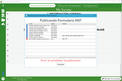

Hi everyone, I am having an issue with Survey123 Connect. It works properly on the Connect when I run it, but by the time I want to publish it through Connect, an 499 code error shows up: " Error transferring https://survey123.arcgis.com/api/beta/xform2webform - server replied: Proxy Error.
I already saw a similar case and the response was an instability on the server, but I have waited couple of weeks and still does not work by publishing it daily. Same error pops up.
Any recomedation?
I would appreciate any assistance. Need to send a project and haven't added this yet. Have a nice day,

Could you please retry? We saw some minor issues with the Survey123 API this morning that have been addressed.
SebastiánArdila
Nothing! Still same error, same code. I have been trying for 2 weeks and same issue.
JamesTedrick
Esri Esteemed Contributor
Hi Sebastián,
Does your survey have a long set of choices?  This is the most common issue when specifically at the webform processing.  If so, make them an external select, if possible - Cascading and external selects—Survey123 for ArcGIS | ArcGIS
SebastiánArdila
Hi James,
Yes, I have a long set of choices (almost 10.000). I was just thinking about creating an external sheet, but did not see it necesary because it works on Connect. I will try and reply later. Thank you so much.
SebastiánArdila
Hi, James,
It did work!! Thank you so much, I really appreciate your recomendation. Now it published so fast.
