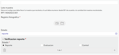

migforst6
Hi, greetings for you.
Thanks for your answer and your help. What I need in this case is that Admin user can edit the repeat question (does not matter whether the survey was sent by admin or fieldworkers) and fieldworkers just record everything that goes before the repeat.
