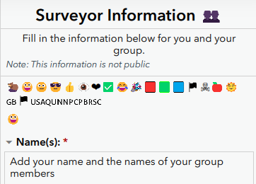

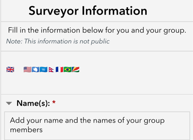

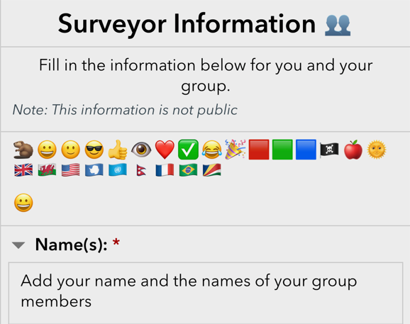

I've been developing a form in Survey123 Connect version 3.25.27 that uses emojis in the labels for some notes and groups. While testing the form, I noticed these emojis weren't showing up at all on my Android device (Pixel 6a, Android 16). They do, however, show up fine on my colleagues iOS devices. We tested a different Android device (Samsung Galaxy S25) and found they didn't show there, either.
I made a test note with multiple different emojis and found that only the "flag" emojis rendered on Android:
Screenshot 2026-05-22 163015.pngScreenshot 2026-05-22 163015.pngChaseGunnell_0-1779489449851.pngChaseGunnell_0-1779489449851.pngChaseGunnell_1-1779489492480.pngChaseGunnell_1-1779489492480.png
How the form appears in Survey123 ConnectHow the form appears on iOS devicesHow the form appears on Android devices
All of the devices we tested are running version 3.25.32.

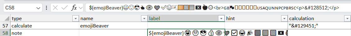

I tried seeing if displaying them using different methods fixed the issue including:
  • directly copy-pasting the emojis from an external source
  • using HTML number codes
  • referencing a calculate question with the HTML code as the calculation,
But none of these methods changed this behavior. The test note uses all three of these methods:
