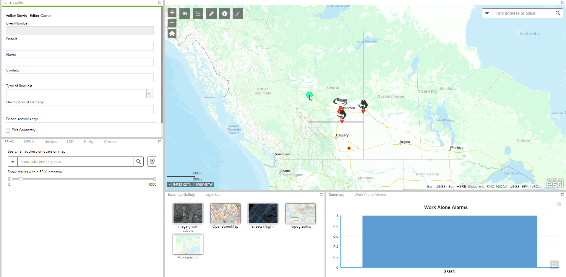

We are a public safety call center and have our agents capture data directly in GIS.  We are currently using the Smart Editor in Web AppBuilder.
This works okay.  But it presents a number of challenges.
  1. Editing the form logic in smart editor is cumbersome, especially for large forms.
  2. The interface is visually limited.
  3. The more sophisticated features from Survey 123 (calculations, etc) are not available.
  4. Having multiple users access the same feature at the same time causes read/write issues.
