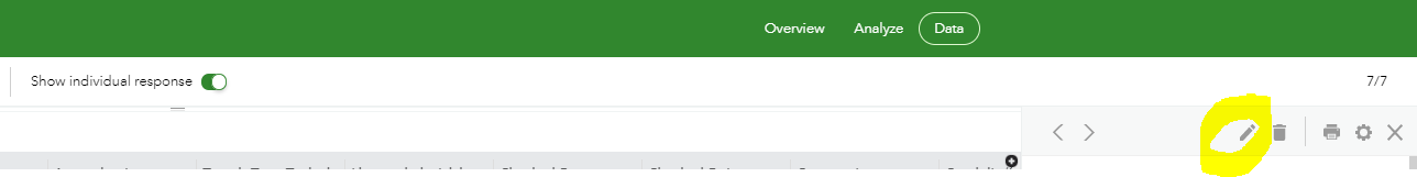

I have a user with Editor level AGOL license but they cannot edit records in the Data view of the S123 URL. They do not see the pencil icon (circled in yellow in picture).

I am the owner of the survey but need to allow a handful of "power users" to edit the data after the form is submitted somehow - what is the best way to do this? Should I just link them to an AGOL map with the Hosted Feature Layer and let users edit in the attribute table?

To edit an individual response in the Data tab, a user must have both submitter and viewer privileges and be able to add and update records. Please see this page for more info: Edit existing survey data—Survey123 for ArcGIS | Documentation
