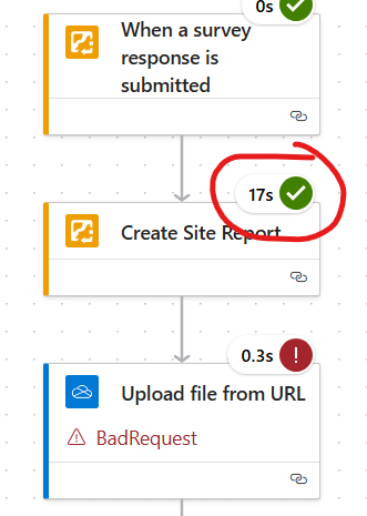

Even though the report finishes successfully, if you look at the raw output, it shows a failure:
    "statusCode"200,
    "headers": {
        "ETag""W/\"4e2-6R34h/AwilzxBiPzwGpn5vzv0XM\"",
        "Vary""Origin,Accept-Encoding,Authorization,X-Esri-Authorization",
        "arcgis_connector_version""ArcGIS 2026.2.0 2026.05.13 1778680964496 45012c",
        "X-Powered-By""Express",
        "x-ms-environment-id""default-20b4933b-baad-433c-9c02-70edcc7559c6",
        "x-ms-tenant-id""20b4933b-baad-433c-9c02-70edcc7559c6",
        "x-ms-dlp-re""-|-",
        "x-ms-dlp-gu""-|-",
        "x-ms-dlp-ef""-|-/-|-|-|-",
        "x-ms-mip-sl""-|-|-|-",
        "x-ms-au-creator-id""7d3cd2c3-b152-4636-8118-2dd431bd390b",
        "Timing-Allow-Origin""*",
        "x-ms-apihub-cached-response""true",
        "x-ms-apihub-obo""false",
        "Date""Thu, 18 Jun 2026 16:14:25 GMT",
        "Content-Length""1250",
        "Content-Type""application/json; charset=utf-8"
    "body": {
        "jobId""fff47b8f7dd74683afc86f003c9c2528",
        "jobStatus""esriJobFailed",
        "jobStatusInfo": {
            "detailedStatus""prepareFailed",
            "startTime"1781799251033,
            "progress"0
        "submitted"1781799250864,
        "completed"1781799264444,
        "resultInfo": {
            "title""FWDSiteVisitReport"
        "inputInfo": {
            "jobType""createReport",
            "parameters": {
                "featureLayerUrl""https://services5.arcgis.com/<orgID>/arcgis/rest/services/service_<ServiceID>/FeatureServer/0",
                "queryParameters": {
                    "objectIds""695"
                "templateItemId""<templateID>",
                "surveyItemId""<itemID>",
                "portalUrl""https://www.arcgis.com",
                "outputFormat""pdf",
                "outputFileName""FWDSiteVisitReport"
        "messages": [
            "An error occurred when querying data from the feature layer. request to https://services5.arcgis.com/<orgID>/arcgis/rest/services/service_<serviceID>/FeatureServer/1?f=json&token=almDQnmPugMjmZy0rs4ypKQ..anHPBFp4DBk0f7qUGSkeVIb7DerHBhU0PL9tuhnriN1WioYjXHoyEhcnupoKXRuMpylVhew62bTo8PhZHV6vJv_TSnlXyyT3sLmbi1ps6rUmA7VSXpawEbEfU1XLc5uoWx5KuZ1juM4IuW51SqHQIBHGsE3qPH3nBmMDf3WUCPvUWROs4HEttDfVY2t84_dnq1T-mUGuj4cppWzzCUWUIzqwfEfiVondqvf8z4gISE3xGTN3iM0LXtzPTN0NxCWj34NI4nv8-Q-2L9Q3Q_8. failed, reason: read ECONNRESET"

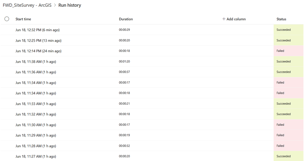

I want to comment on this so it is known that @ANRGIS is not the only one seeing this issue.  My organization just submitted a ticket regarding this.  As reported here, it is hit or miss.  My workflows are setup to keep trying every minute for 10 minutes.  Most are going through after several tries, some go through 10 tries and fails completely.  Manually generating provides the same results.  Something fishy is going on.  Hopefully we get to the bottom of it.

After running several sample reports, it does appear to be working more consistently. I will report to our field teams and will resume reporting operations. Thank you for looking into this for us!
