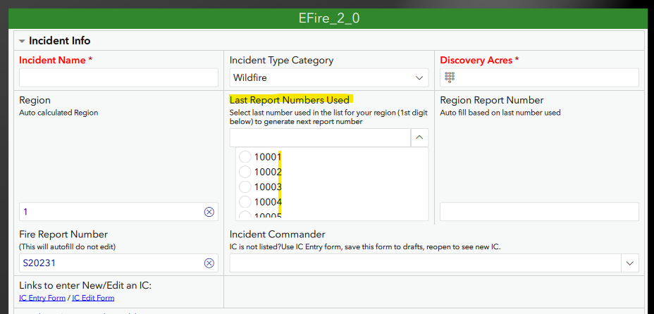

Hi Folks,
I am suing the search appearance question on a hosted feature layer to pull a list of report numbers for a particular region where the report numbers are sequential by region. I am successfully getting just the list of report numbers based on the user's location region so the last number used can be selected to derive the next report number for the user. However I would like to have this list presented in descending order so the user doesn't have to scroll to the bottom of the list before making a selection (see screen shot below).
Does anyone have a solution for this? I have played around with the orderByFields in the expression but everything I have tried has either broken it or not sorted in descending order.

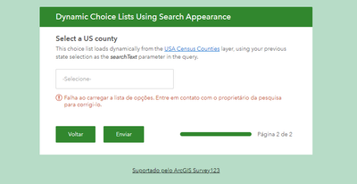

SMH-Rio
This solution only applies to the Field App, correct? In the Web App, the message "Failed to load picklist. Please contact the survey owner to correct it." appears. I tested both the attached xlsx and one I made.
AnnaJose
Hi @ZacharySutherby was this ever fixed? I'm having the same error message as SMH-Rio in web app. Trying the US states layer, sorting worked. But somehow the sorting doesn't work for my layer. If I remove the URL parameter, the list loads just fine.
