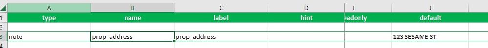

I'd love to set up a dynamic form title for my surveys. The obvious way doesn't seem to work. users often flip between multiple draft forms and it sometimes requires scrolling back to the top of the form to make sure you've got the correct one open.
Is there another way to dynamically set the form title, or to have a specific piece of information (such as address) always shown on the screen?

Hi @RobertBlashadmin,
The solution for survey123 excel. Survey123 version 3.17.55
I also leave the post including solution that I used for the solution below.

ezirhli
Variable form title
RobertBlashadmin
Thanks @ezirhli this is awesome!
