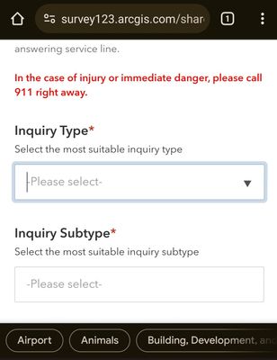

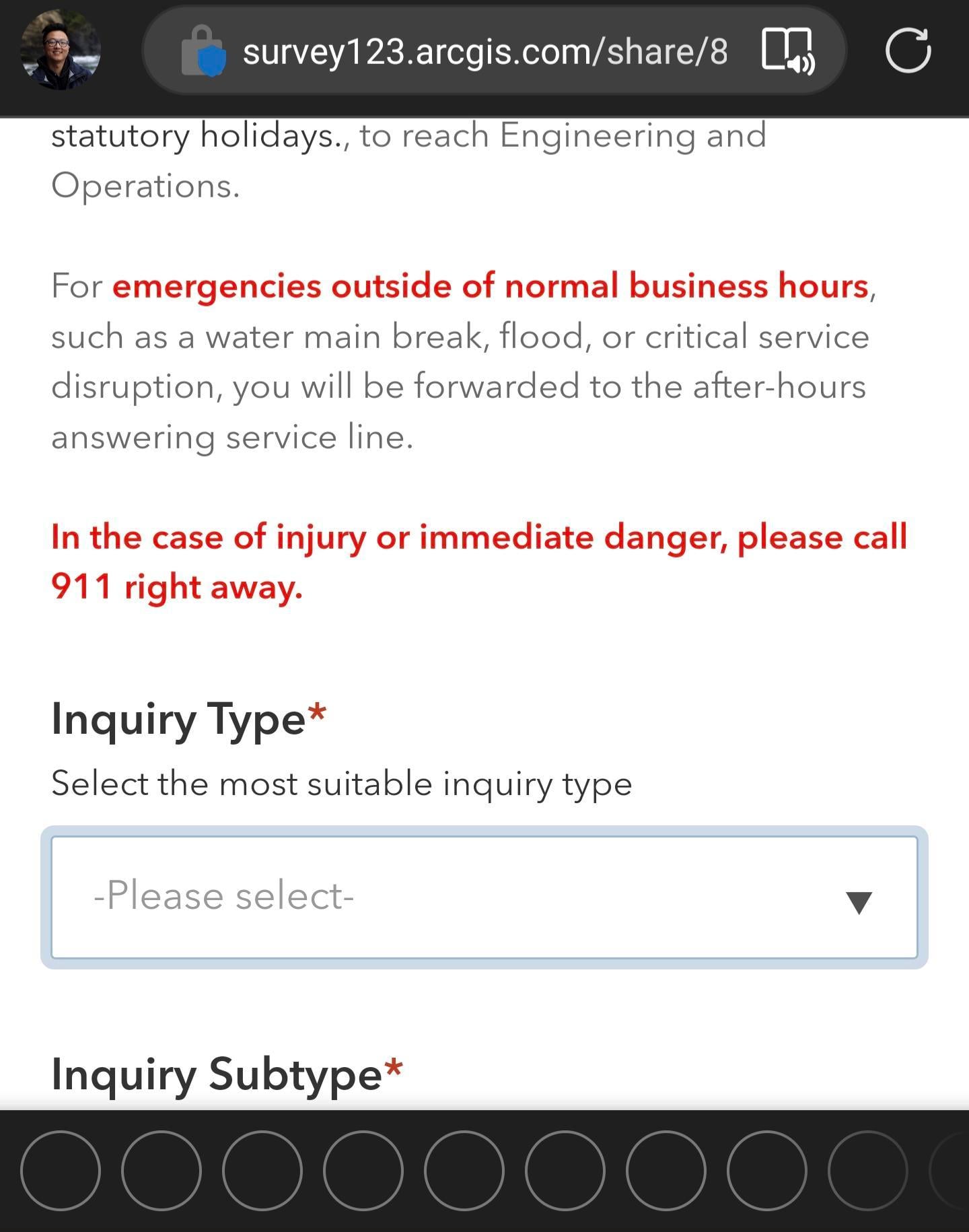

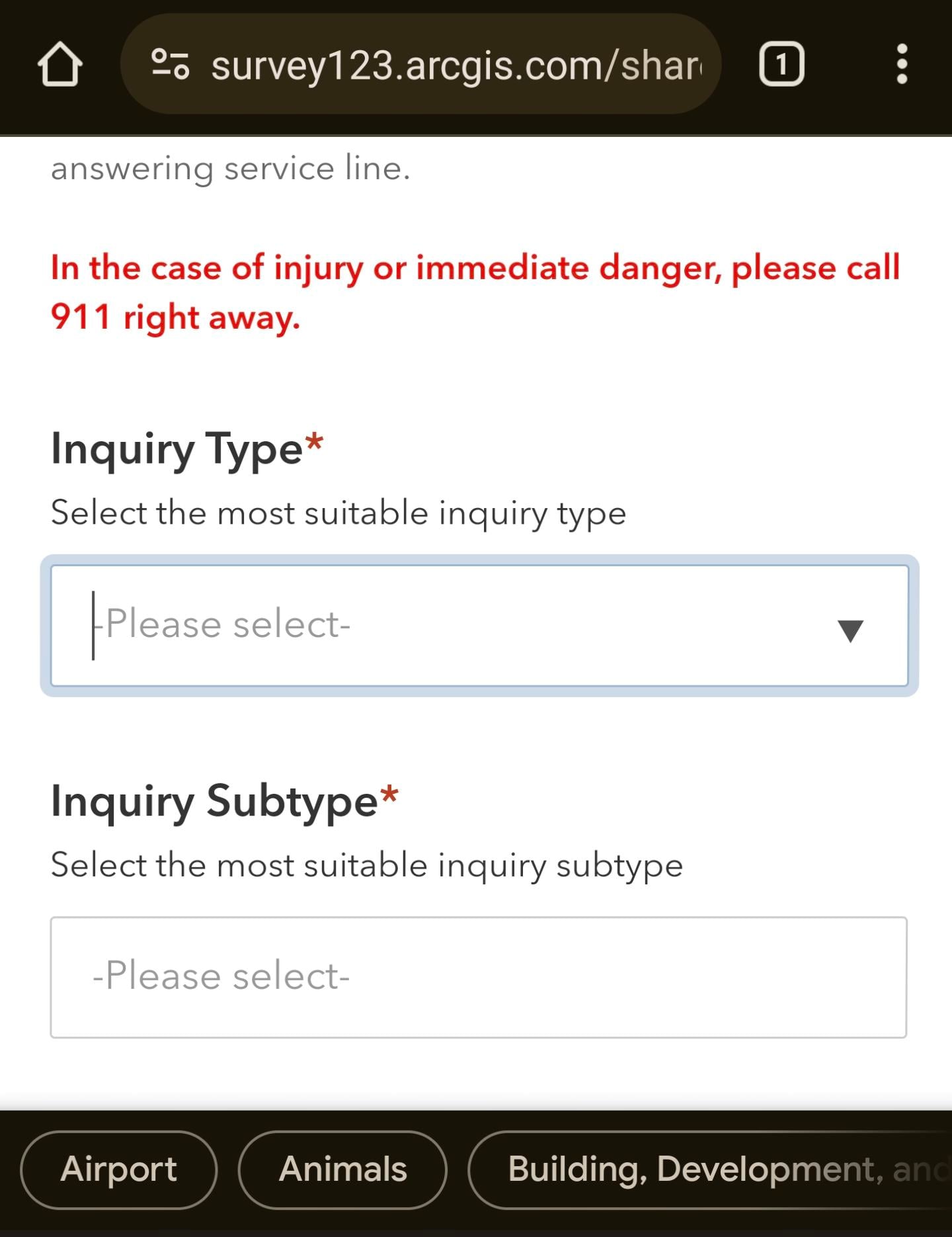

Have anyone been experiencing dropdown list options shown as "empty" circles using Edge (Android 118.0.2088.58) with Survey123 3.18 or 3.18 (Beta)?
Chrome (118.0.5993.80)
Edge (118.0.2088.58)
While I thinkg this is a browser issue (Edge - Android), this can impact all edge (android) users to not be able to see the dropdown options especially when options were loaded from a layer.
Any help would be great 🙂
I also tested with Edge (Beta) - Android [120.0.2173.0] and Edge (Canary) - Android [120.0.2173.0], and get the same result.
I will report to Edge Android team regarding this issue also.

Dear Esri Survey123 Team,
I’m reaching out to follow up on an unresolved issue that continues to impact our organization. In local government environments, many users rely on Microsoft Edge on mobile devices for SSO and store credentials for optimal user experience and cybersecurity. Survey123 is a critical tool for our operations, and we use it extensively across departments.
However, the persistent issue with dynamic dropdowns from feature layers not rendering correctly—showing only empty circles in the mobile version of Edge—has become increasingly frustrating. This limitation significantly affects usability and undermines confidence in the platform.
Could this issue please be prioritized for resolution? It has been outstanding for over two years, and we’re eager to see Survey123 continue evolving as a robust and reliable solution.
