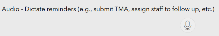

One of the questions allows the user to use the Audio feature to dictate reminders (i.e., click on the microphone and record any follow up issues, such as, work orders, missing fire extinguishers, expired first aid kits, etc.) .    I don't know how to make the dictation automatically transcribe/convert to text.
When I downloaded the PDF report, it's an icon of a mp3 file.  But, you can't listen to it because it's a PDF.  Is it possible that the dictation is automatically transcribed/converted to text?  If yes, how do I do this?  Please assist.

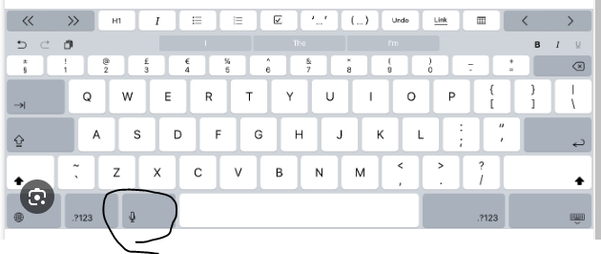

SherryChan
Dear Doug:
I will try that.  I have only tested the Survey123 on my computer and laptop.  Let me try it on the iPad.    Is the one that you circled
SherryChan_0-1687308393416.png  for dictation?  I will try it tomorrow when I return to the office.

SherryChan
Hello!
In the spreadsheet, I changed the "type" to text vs audio.   This way, the keyboard appears and you can either  use the microphone to dictate or type in text.
When the "type" was audio,  a microphone icon appear on my survey (i.e., no access to the keyboard) and it only allows one to record and the end result is a mp3 file which can't be heard in the report because the report is a PDF file.
So, that was an easy fix.
