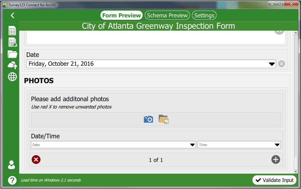

Have the function ()now in the default field for a dateTime field that is in a repeat on the XLS form.
Yet the form does not populate the dateTime field with the current data

Ismael Chivite‌ I am still experiencing this in beta v3.1.65

Please email me the form. I cannot reproduce the problem. I used a modified version of the  the Nested Repeat sample to test.  There could be a combination of things that produce the problem you are seeing.
