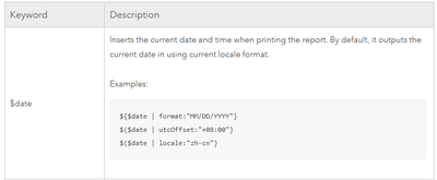

You can specify a format for date_time in reports as per above.

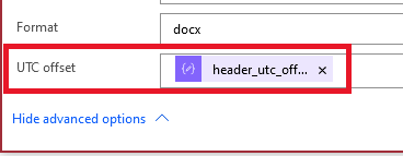

If you are creating reports via automations, there should be a setting in Esri's report step that does this for you (it replaces utcOffset). If you are just generating reports through the S123 Website though, you will need to stick with utcOffset, or do the conversion in the survey itself (My personal least favourite method).

Can I format the date and utcOffset at the same time?  ${datetime | utcOffset: "+6:00"} ${datetime | format: "MM/DD HH:mm"} ?
abureaux
MVP Frequent Contributor
Try ${datetime | utcOffset: "+6:00" | format: "MM/DD HH:mm"}
CodyHarris
Thanks.  That was easier than i thought.
