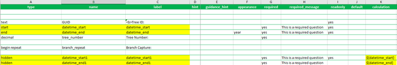

Ok I figured it out, pretty simple.
Instead of using datetime with the now() calculation, rather use the field types "start" & "end" on your main form. Then setup a calculation using the "end" on a datetime field in your repeat. By default the start and end field types are hidden. I have tested this and it works offline using the survey123 field.  Illustration below.
The start field type will be once off when the form is created, however the end will become the date the form was last captured on.

SpatialSpeedy
