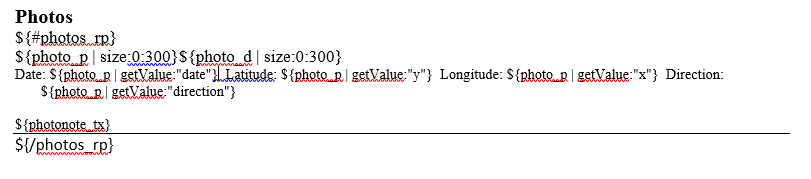

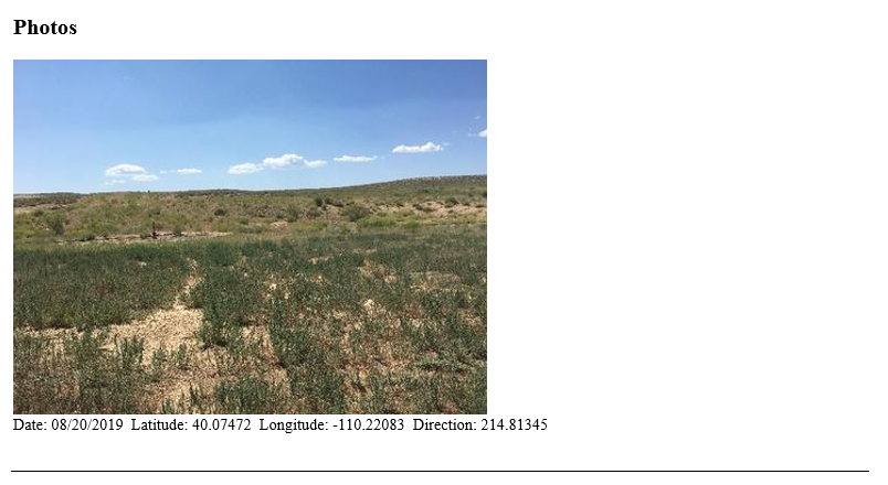

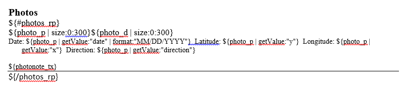

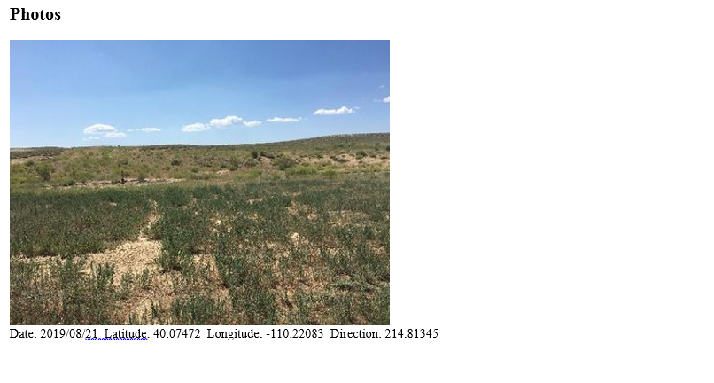

BUG? On our feature reports we display the date using ${photo_p | getValue:"date" | format:"MM/DD/YYYY"} However, this has resulted in some photos being printed with the wrong date. Through testing, I have found it has something to do with the format section of the code.
Error Example: Template and result.
Test Result. Removed the format section of code from the getValue date.
If there is a fix for this issue, please let me know, the users are accustomed to seeing the date in MM/DD/YYYY.

Can you please confirm that you are seeing two separate issues?
1. When formatting a date in the report template, the date that is returned is a day off
2. When not formatting the date in the report template, the date is returned in format YYYY/MM/DD
Thank you,
Brandon
NicholasDay
Hi Brandon,
The second is not so much an issue, more a preference; which is why I tried to use the format function. The first is an issue, the date returned when the format was applied was one day off.
