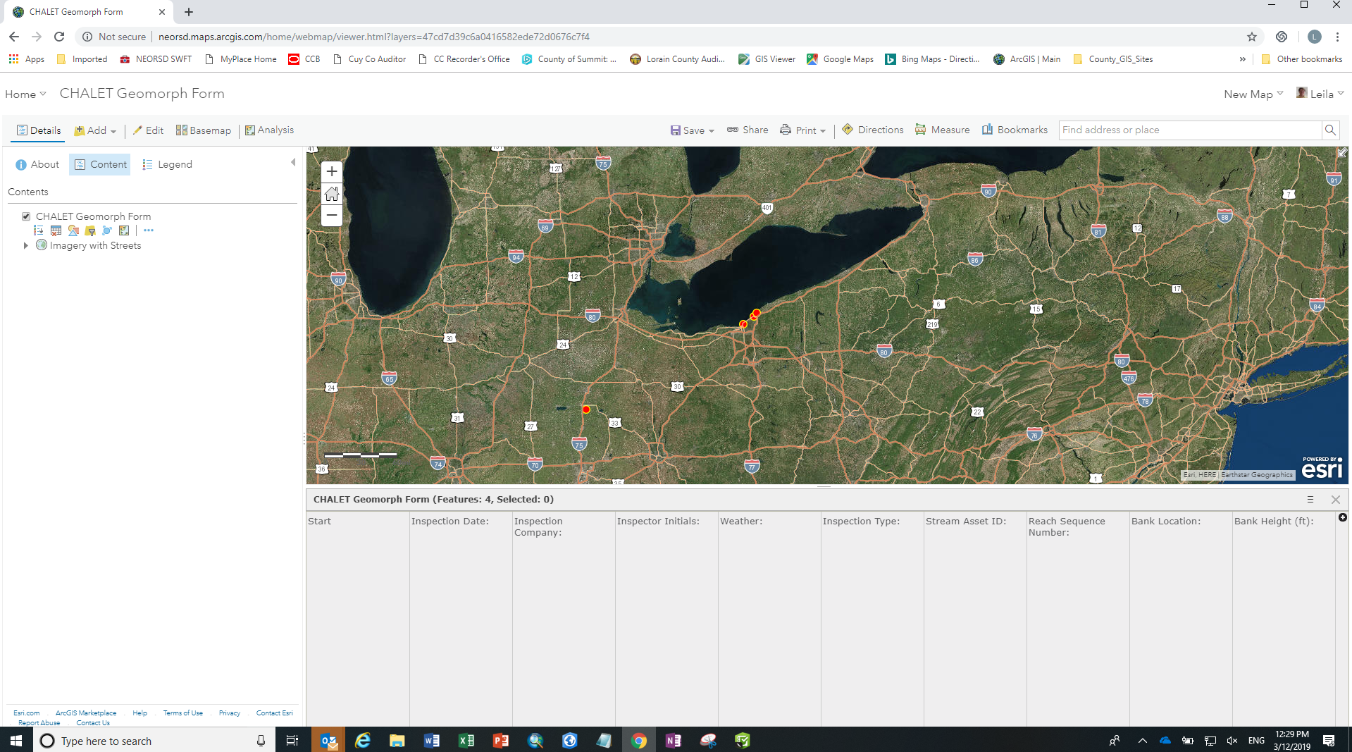

I have a hosted feature layer that was created as part of a Survey123 connect form. While I can see the data in data view for the layer, I cannot see any data rows when I open the table in a Webmap (see image below). I removed the survey folder from ArcGIS online and the survey from Survey123 Connect and uploaded the XLS form to a new form in Connect and republished to AGOL, but am still having the same problem. Does anyone have any thoughts what the issue might be? Thanks!

We resolved this - it turned out we had some very long notes in the label field that was preventing the data rows from being shown in the data table. We moved the notes to the notes column and all was resolved.
