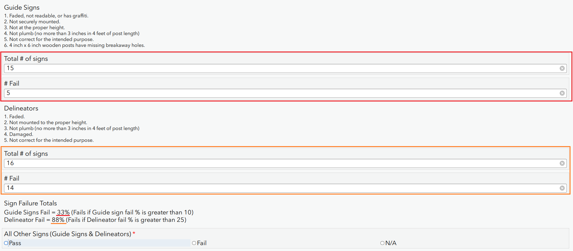

Survey screenshot
In the attached screenshot the main question is "All Other Signs (Guide Signs & Delineators)"
The highlighted sections above are fields to calculate fail % so the person taking the survey doesn't have to take any extra notes or do any calculations on the side.
If possible, what I would like to have happen is:
If both totals fall under their % limit - Pass is automatically selected.
If one or both are above the % limit- Fail is automatically selected.
If total # of signs = 0 in both fields - N/A is automatically selected.
Is it possible to have a Select_One question auto-populate based on previous answers or selected criteria?

Hi Chris - unfortunately it is not possible to use calculations to update select_one questions (in your case we would want to update the select_one using the answer to a previous question). I will get you added to the enhancement request we have open for this functionality.

Yes, calculations will be supported on select_one questions as of version 2.7, which will be released in the next few weeks.
