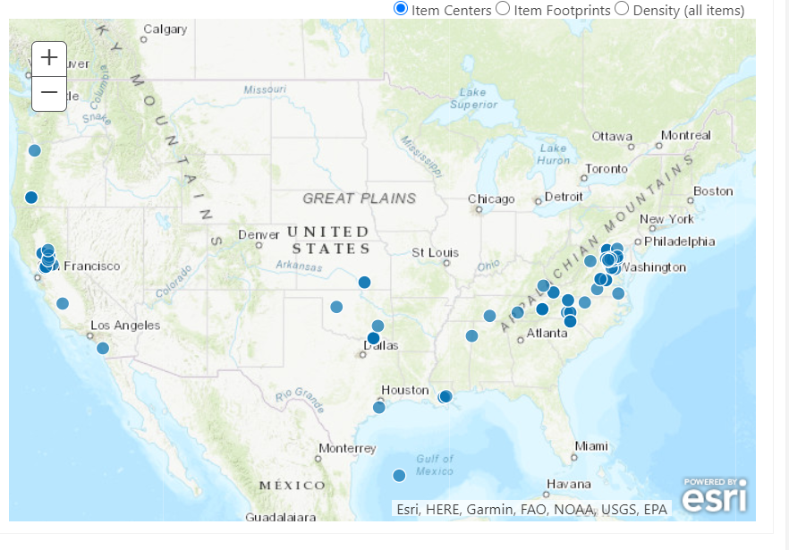

Ideally, I would like the survey to create a point automatically based on the projects center, something like this map which is automatically generated and viewable within the Organization > Status > Content tab:
Is this possible, or is my only choice to use a geopoint question and have the analyst submit a point manually within the survey? I've considered that option as a backup, but I've been requested to make this functionality automatic if possible, so I thought I'd see if there were any ideas out there.
