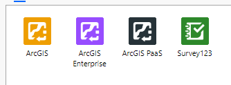

The Survey123 connector is not part of the new Enterprise connectors (this is why you don't see it mentioned). You can see the high level "buckets" in Power Automate where S123 is it's own entity.
I'm not on the Survey123, nor the team developing the Enterprise connectors (I come from core webhooks in Enterprise), so at the risk of saying something incorrect, my understanding is the S123 connector is hardwired to connect to ArcGIS Online and will only find surveys in there, thus they cannot use this connector for Enterprise. Looking at your guide - you have specific instructions on an Enterprise connection to S123: I've never seen this before, and I don't see it now while looking through PA. Perhaps my knowledge is out of date, or my subscription doesn't have the correct access. Apologies if I've posted some incorrect information. Please do correct me if I'm wrong.

Those are the only pre-built Esri connectors I am aware of. The "Survey123" connector listed there is for AGO only.
