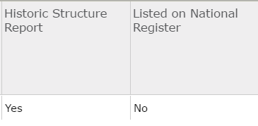

If Survey123 version 2.1.9 has capability adding domains for the select_one question, would you be able to point out where am I doing wrong or missing (please see the images below)?  I would like to save coded values to the Feature layer instead of "label" of created choices.  However, I haven't been successful.  I searched an answer for my particular problem, but I am having difficulty finding the answer.  I would very much appreciate your assistance.

Image 4: Collected data - I don't understand why it stores "label" instead of "code"...

Hi Makiko!
  • The behavior has not changed: Survey123 Connect will always create a domain for your select_one questions, except if your select_one has an expression in the choice_filter  column.  The choice_filter makes your question be a 'cascaded select'.
  • Select_ones will always persist the value in the NAME column of your XLSForm choice list.
  • IF a domain is present, ArcGIS clients will display the label rather than the NAME (coded value domain), but the actual stored value will always be the code. You can see this when downloading the data to CSV format for  example.  If you query programmatically your data you will also need to use  the codes.
  • You can create surveys from existing feature layers.  Check item 7 in https://community.esri.com/groups/survey123/blog/2017/04/10/10-facts-you-may-not-know-about-the-surv...  When doing this, you can actually build cascading selects that have domains.
