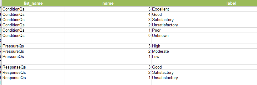

Hi - I have an established Survey which was published from Connect a couple of years ago. In the survey I created some Select_one questions with a coded number for the name and a descriptor in the label as shown below:-
As I now want to chart these numbers in Operations Dashboard I realise that Operations Dashboard/ArcGIS online will display the LABEL rather than the NAME (coded value domain), and the field has been automatically recorded as a string. After doing some research I understand that to undertake numerical reporting, I could/should have specified that the question should treat the field as an integer, rather than its default field type of string - but I was not aware of this at the time and the survey now has a number of dependencies.
So my question is - how do I go about utilising these coded values for reporting? Can I add another hidden question/expression field to display the coded values rather than the name?
Any assistance would be welcome, thanks, Tom.
