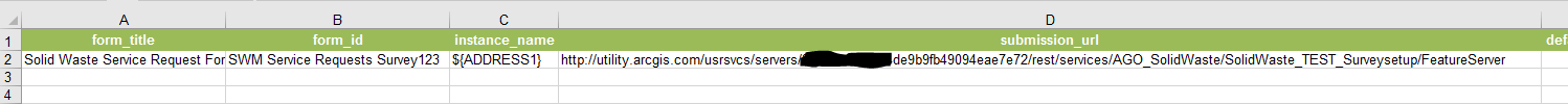

The survey was created using Survey123 Connect Vers. 1.10.43. I generated the XLSForm by logging into my Organization and using the Create Survey function. I made certain that the submission URL and form_id were correct ( I followed an example from a previous form).

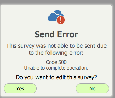

I get a Code 500 (Unable to complete operation)
The submission URL and form_id worked in generating the survey. However I'm now wondering if the permissions are somehow getting lost when the survey attempts to create a new feature?
This is a very unhelpful code as I am unable to pinpoint exactly what's going wrong.

In looking at the screenshot, the form_id is "SWM Service Requests Survey123", correct?  That is the name of the layer in the service that is the main form?  If so, there is a known issue with layers that have spaces in their name.

That's good to know! I'll change the layer name and republish.
ErickWiggs2
I renamed the layer without spaces or special characters in my original mxd, republished, re-secured, and remade the survey. I am still getting the same error code 500.
