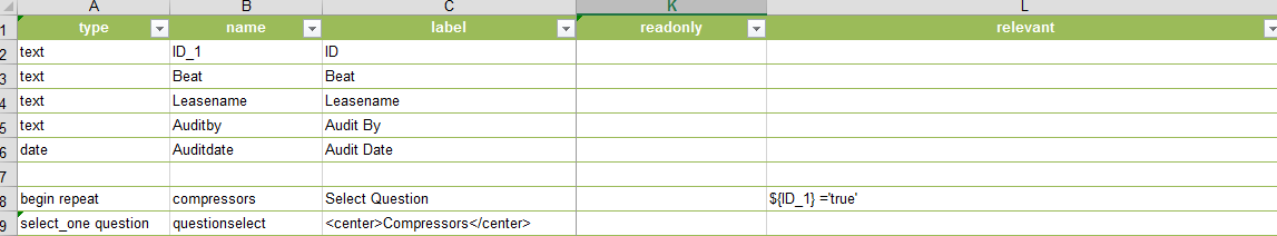

I have attached the table below.
I am able to create the table and download it to my device. I get the Code 500 JSONArray[0] error when I try to submit.
I am trying to include multiple photos in a repeat, not sure if that is my problem?
Any suggestions?

Hi Tucker,
I'm not seeing the JSON array error, but I am seeing a failure to submit data caused by the hidden 'Auditdate_' field. By default, hidden questions are of type 'text', issues arise in converting that to date on submission.  You can add a column named 'bind::type' and set the type of data for that column to 'date' - this leads to successful submission for me.

Also, should I be able to do a relevant (='true') on a repeat?
JamesTedrick
Esri Esteemed Contributor
Yes, relevancy works on displaying repeats.
TL2
Is ${ID_1}='true' the correct syntax.  When I do this it hides the repeat, but when I enter something in ID nothing happens.
TL2
I am trying to make it so any entry displays the repeat.  I see now that when you type 'true' that makes it display.
JamesTedrick
Hi Tucker,
I would use the string-length function to evaluate whether a text field is blank or not:
string-length(${ID_1}) > 0
