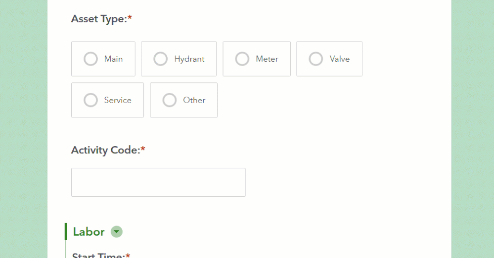

I have a choice_filter selected(${asset_type},asset) that is working on mobile version of the survey
but is not working when I open the survey on the web on a computer.
I have attached the xslx file for the issue.
IsmaelChivite
Esri Notable Contributor
Hi. The only problem I see with this survey is in row 205. After removing property('email') everything works as expected in the web app with the choice filter in row 5.
We stopped supporting property('email')  a while ago. You ca use pulldata("@property",'email') instead.
