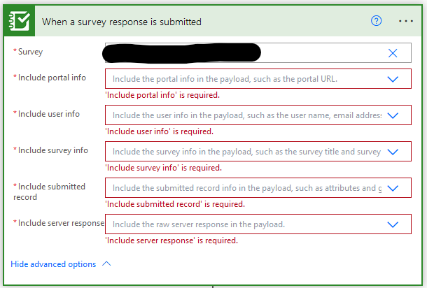

I needed to update a flow in Power Automate this morning and was receiving some weird errors that prevented me from saving the flow. Then I noticed that the Survey123 connector was different and requires these parameters now:
I am worried that this change will break any flow which contains the Survey123 connector. Can anyone shed light on the impact this will/will not have on existing flows? @SeanKMcGinnis  tagging in case you have insights.

Hi @erica_poisson,
The Survey123 connector was updated to add an action for creating reports. If you edit a previously created flow you will need to manually set the new parameters in order to save the flow. The defaults values for all of the new parameters is 'Yes.' Existing flows will continue to run without interuption, it is just when the flow is edited that the new parameters need to be added.

KhemAryal
@erica_poisson I had the same issue. I changed all to 'Yes' and everything working fine. No issue on the flow yet.

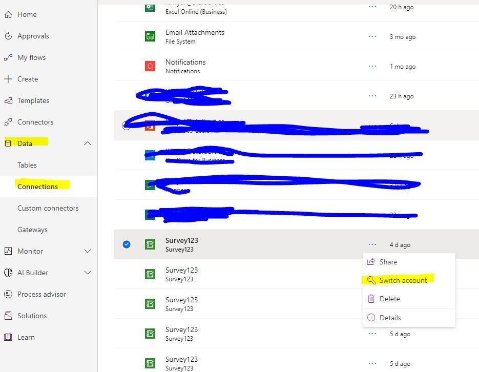

KhemAryal
I suggest to go to the 'Connection' from 'Data' menu. Click on  3 dots beside it and select Switch Account. It will prompt you to sign in. Once you sign in or allow connection. you will see the surveys populated. I hope this solves your problem
RobertAnderson3
MVP Regular Contributor
Unfortunately that did not, was the first thing I tried. I think the update to the connector for the reports broke something.
I created a new connection and it populated, but using it in an existing survey things still aren't acting quite right it seems. I ended up rebuilding the two I needed today from scratch.
