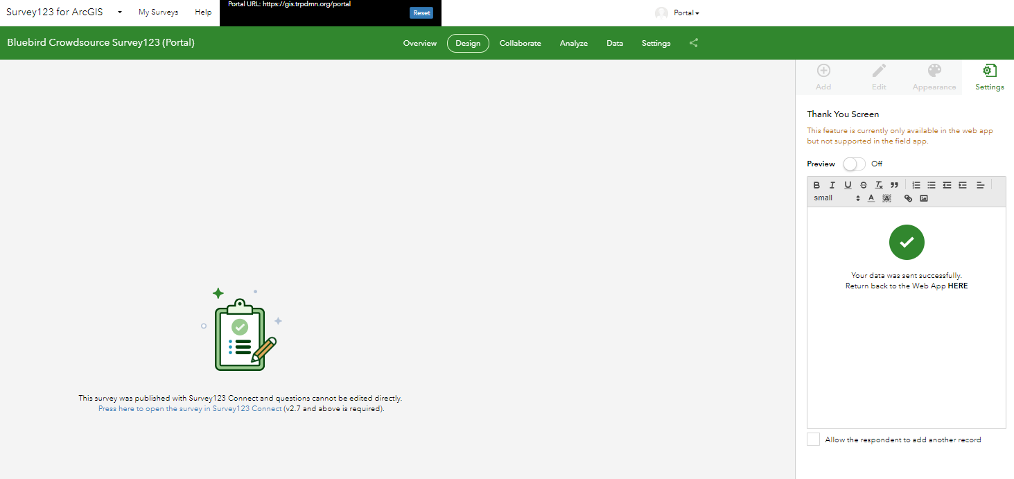

Our organization is thrilled with this new functionality, but when our publishing from S123 Connect 3.3.51 to Portal (haven't tested in AGOL yet) the thank you screen is configurable but after publishing changes, the survey does not reflect the new message and the default message still appears. This behavior is reproducible across all browsers (Chrome, IE, and Safari)
We have opened an Esri Support case regarding this behavior, but I thought I would pass it along here as well.
 Custom message published
Not applied, only default message:
Any resolution would be great.

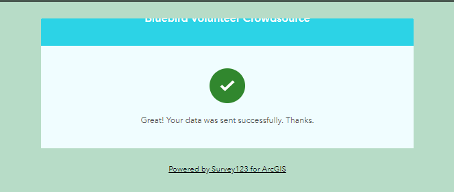

I may be missing something.  I have a survey published using 3.5 and when I edit the submission message in the Survey123 website and publish the changes, the submission message remains default.  I have "use latest version" checked under settings.
The survey is located here: https://arcg.is/1OqTmW
