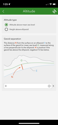

Also, in the Survey123 mobile app, go to Settings-Location to set the altitude type as appropriate for your GNSS receiver
