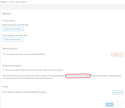

Chris_S
The button is hidden...
To find it and create a new view:
  1. Open the hosted feature layer for which you'd like to create a new view.
  2. Click on the 'Settings' tab at the top right of the screen.
  3. Scroll down to 'Public Data Collection' and click on the link for 'creating a read-only view layer.'Chris_S_0-1720634232677.png
  4. A pop up should appear where you can specify the new view name/folder location/etc.
I sure wish ESRI would update the documentation to include this as it would have saved me several hours.
