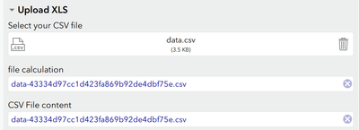

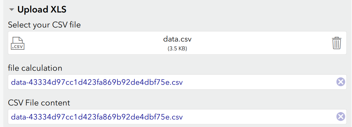

Thanks for adding support for file attachments in surveys 🙂  Of course this leads to other ideas..
Is it possible to use or access the contents of an attached file within the Survey? Either through a calculation, or I guess more likely in a pulldata javascript function?
I have a file question in my survey, and when referring to it in calculation only the file name + i guess its internal item id is returned.  Before I pursue other options to parse the files after submission, i just wondered if there was a way to do so in the survey?
I'm thinking along the lines of validating a CSV using Javascript and using some of the content to populate repeat questions.
Thanks
Andrew

Interesting idea.
Have you tried
pulldata('data', 'MinPercent', 'CoverNum', ${GroundNonWoodyCover})
or (sorry cant copy paste the name)
pulldata('data-8973452978259823490hisff', 'MinPercent', 'CoverNum', ${GroundNonWoodyCover})
Hope that works just a guess
