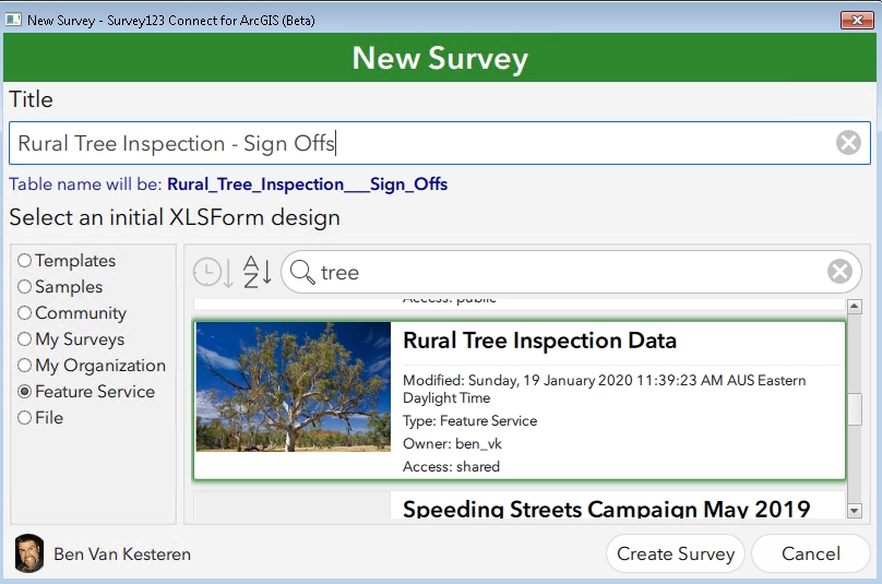

When I created the new survey, I selected the option 'Feature Service' as per below, in the hopes that when the form is completed and ready to upload, then the form will edit the original feature layer created when the first survey form was published.

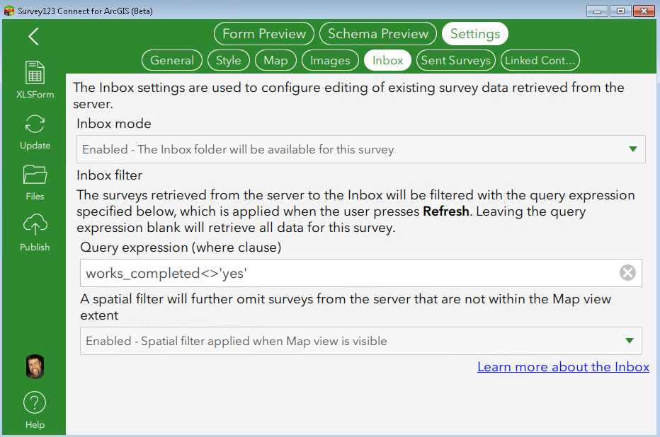

Then created my questions as described above, setup the INBOX so that with this second survey will be used to sign off tasks created by the first survey, also included a where clause:

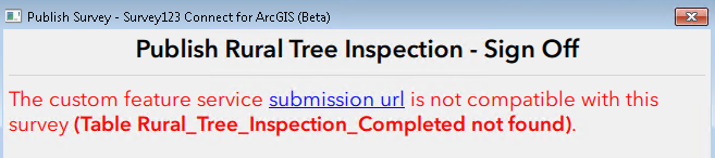

I then try to publish, but I get this error:
which I am a little confused about, as I thought by selecting 'feature service' from the new survey screen I was telling this survey to update an existing feature service, but this looks to me as though the form is trying to create a new survey for a table that doesn't exist.

It was a simple issue that was causing my headache, I had to go into my second survey form, and make sure that the FORM_ID matched the feature layer I was trying to use from my original survey!
Simple as that!
