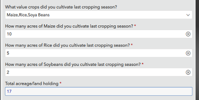

below is a screenshot of it in action:
KayManuel
Thanks a million @j-bromp ! You're a lifesaver. It worked perfectly. Cheers!

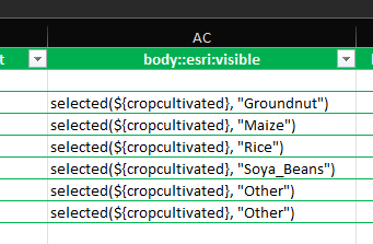

@j-bromp 's solution is the way to go as there will be no answers if the questions aren't relevant, but an alternative option would be to a make all the acreage questions not visible until the conditions are met instead of not relevant. Then your original total calculation should work.
KayManuel
That makes a lot of sense. It works as well!
