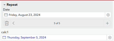

What you have should work (tested in Connect and web, assumed to work in Field App):
Just make sure the MAX() is outside the repeat.
