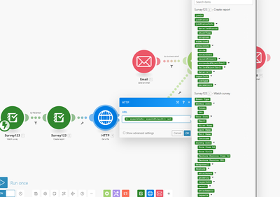

I have this Survey 123 and Integromat scenario setup like this: What is the problem with the S123 when I get the BundleValidation Error and states it needs a valid URL?

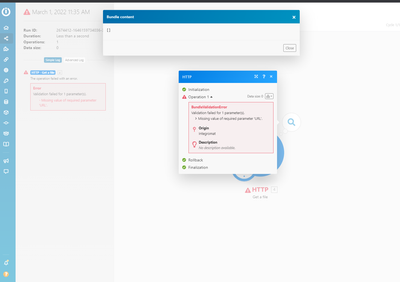

I am getting a BundleValidation Error in integromat at the Get a File HTTP Module, and when I look at the settings I see nothing in the fields.

It looks to me like you have a pipe character ( | ) just before your URL in the "Get a File" module.  Try removing that.
I think that's your issue, but if it's not....make sure that your report was actually successfully generated by the "create a report" module.  After you run it, click in the "1" bubble above the module and expand the result files group to make sure a URL is actually being provided.

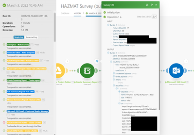

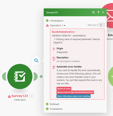

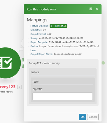

Hey thanks Derrick. That was just my cursor not a a pipe. Great eyes though. I ran the single module and get these results, 2 screenshots below

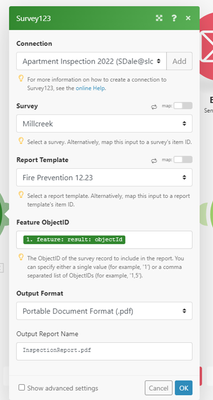

Ahhhh, that looks like your "Create Feature Report" module wasn't set up correctly. Should be a quick fix:
Make sure you're drawing from the correct spot in the "Watch Webhook" module for that objectId, and also double check that your connection, survey and report template are correct.

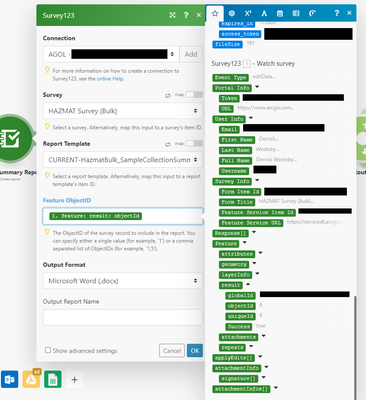

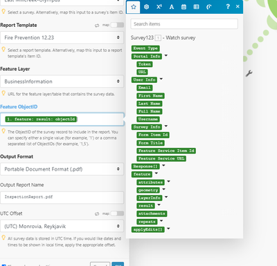

well I have selected all the right files in the interface, connection, survey and report template are correct.  Then I selected the features result objectid (Mapped it). But I show no payload urls in the interface like in the screen cap below. And I dont know how to fix that issue. Do you? Where to click what -I am literally 5 days into this app and issues.

I'd need to see the result of the scenario running to make a guess, if what you have here isn't working (your screenshot looks correct).
This probably isn't an issue, but just to rule out a few potential problems....delete what you have entered in "Output Report Name".
Save your scenario, click "Run Once" in the bottom left, and then send in a test submission.
My screenshot below is what what I need to see in  your scenario.  "Details" should give you an error message if the report fails to generate, and that error message is  your clue.  If the report succeeds to generate, you'll see the URL to download it like in my screenshot
