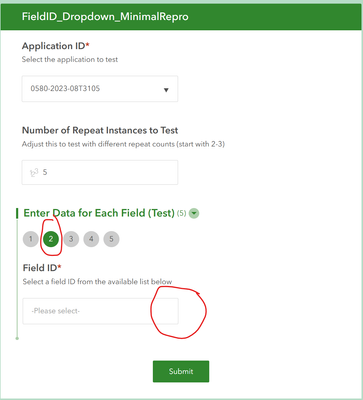

A select_one question using the search() appearance (autocomplete, filtered against a hosted feature layer via a value from outside the repeat) works correctly on the first repeat instance only. On the second and all subsequent repeat instances, clicking the dropdown produces no network request and no visible choice list at all — it is completely inert. This occurs consistently whether the repeat instances are generated via repeat_count or added manually via the "+" button.

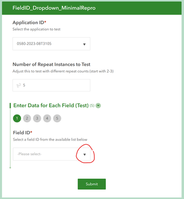

  4. In the repeat, select a value for FieldID on row 1 — this works correctly; a network request fires and the choice list loads.
  5. Advance to row 2 and click into the FieldID dropdown.
Expected result: The same search() query fires (filtered by the same ${ApplicationID} value) and the choice list loads, identical to row 1.
Actual result: Nothing happens. No network request is visible in the browser console (confirmed via DevTools → Network tab — row 1 shows a fetch request to the feature layer's /query endpoint; row 2+ shows nothing at all when the dropdown is clicked). The dropdown remains empty/unresponsive indefinitely.
