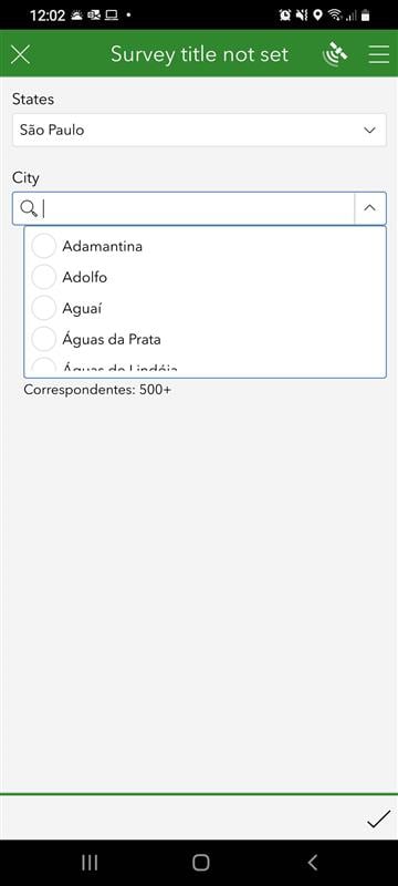

I made a survey with a cascading list from external table choices, States (estados.csv) and City (municipios.csv).

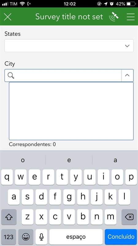

In the Survey123 for Android and Survey for Windows it worked fine, but in the Survey for iOS I just couldn't make it work.
Survey123 for iOS

Hello @PedroGabrielBuenoCesar
IOS tends to be more strict capitalization in file names and file extensions. In your XLSForm you have select_one_from_file municipios.csv whereas the name of the csv file attached is municipios.CSV. That difference in capitalization with the csv file extension is what is causing the issue in IOS.
Changing the file extension to a lowercase csv to match what's in the XLSForm works in IOS.
