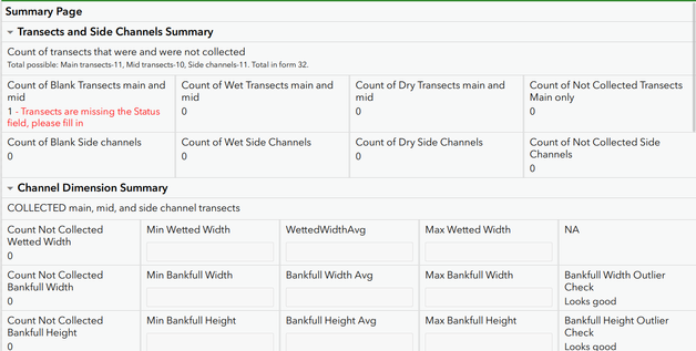

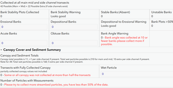

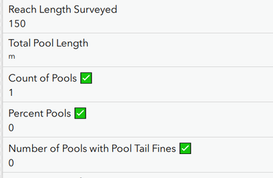

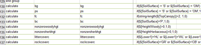

Sounds like you are trying to do analysis in the form.  I have found this does not work out well.  The biggest gottca has been users doing QA or other data fixes in the web map or dashboard.  The calcs do not refire of course so the summary values are often wrong.  If you calc in the form and then just print out a report where is the QA?  Just assuming the crew did it all perfect the first time if not realistic.
A lot of what you list could be done in Arcade and displayed in a Dashboard or even a PDF summary using Data Driven pages or Python/ReportLab (we do both and integrate them).  This way if someone sees a crazy number they can edit the data then the summaries all live update or run overnight.  Getting people off of the addiction to static PDFs has been slow going but Dashboards are getting us closer every day.  PDFs just turn into a pile of paper then everyone says they are busy drowning in paper all day - endless cycle.
I know not totally what you asked for but I think you will spend a ton of time on something that will not work out.  BTW I am doing quadrat and veg surveys also in Wetland, Lotic, and Terrestrial systems.  We collect thousands of plots with millions of records per year nationwide.  So a lot of lessons learned.
Now that said we do have a lot of data summary pages for the crews.  We just do not use these numbers as the final.
For nested repeats you need to double sum at each level.
Level 1
Level 2 sums the sums
Using Grid helps a lot for display
Red warnings are great
I also use emojis
But your calc by species and such is going to be too complicated prob.  Piece of cake in Python though.
