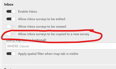

@JoshSmithWCWD Just wanted to add the "copy to a new survey" functionality may provide an in between, while they would still have to submit individual forms, coping a previous entry updating select fields and submitting would definitely be faster.
https://support.esri.com/en-us/knowledge-base/how-to-copy-and-edit-existing-survey-records-in-a-new-...

This is a good solution. But I will add a warning: Depending on your field of work, this may not be acceptable. Basically, if you "copy" a previous assessment, you can no longer guarantee that the form was filled out accurately, which may be an issue if you end up in litigation. If this isn't a risk/concern for you, then have at it.
In my field (Environmental/Property consulting and remediation), litigation is always a risk, so this wouldn't work. But I also get similar requests from time to time for similar functionality from our various groups. In my case, Experience Building (as @MaximilienRIOT mentioned) is the best solution. However, every use-case can be slightly different and mileage may vary.
