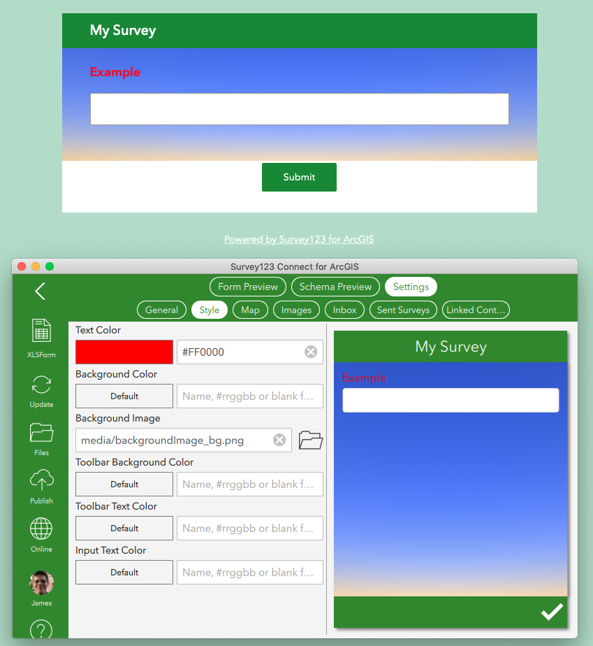

Yes, I can successfully have a background image applied:
You may need to try clearing the cache of the browser - I'm seeing that a field download attempt can keep later ones in a failed state.
