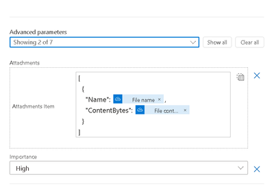

PaulLefaive2
@j-bromp  in the attachments section of your email connector (in my case I'm using Outlook) you'll want to reference the OneDrive filename and file content. Below is screenshot of what my attachment parameters are for attaching a OneDrive file to the email. Hope this helps.
j-bromp
Thanks guys @RobertAnderson3 @PaulLefaive2 ,
Have got this working :). Ended up using the http get method and including that in the attachment for the email.
