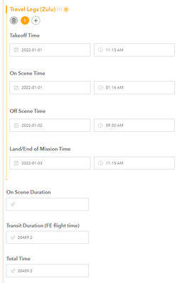

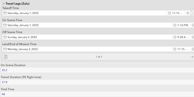

Why are these calculations working in connect and field app, but not webform?
chelynnes
Field app :chelynnes_0-1643127564259.png
Web :
Ok, so the calculations are doing something,.. but theyre not being read the same in the web and field app?
